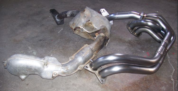

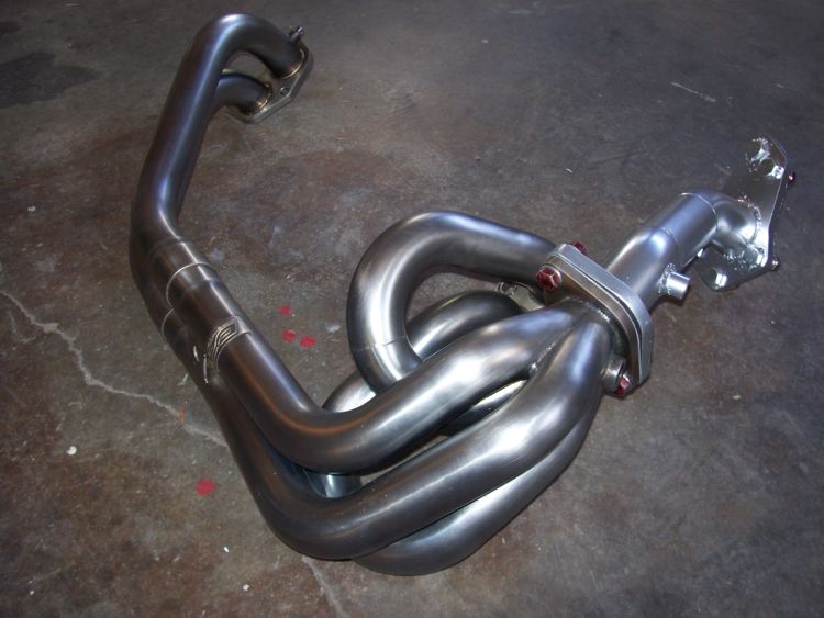

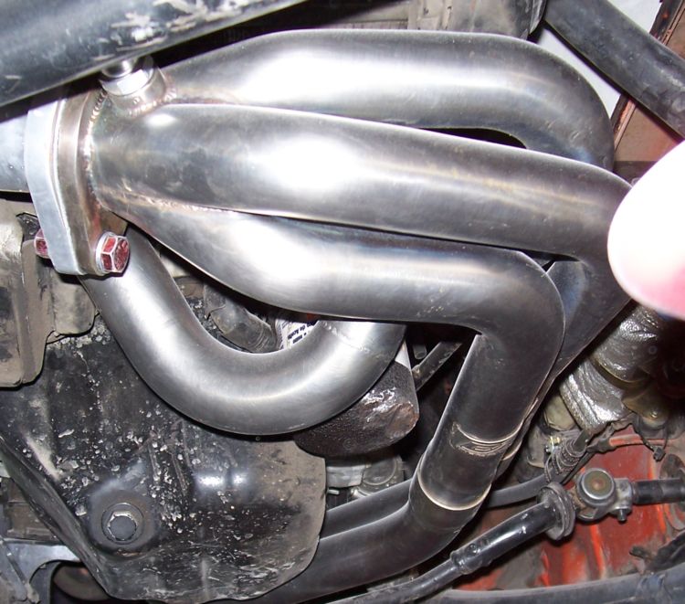

So I finished my other project for the day, say hello to 5 gallons of sweet cherry chocolate stout! Give it about a month and it will be perfect. (IMG:style_emoticons/default/beerchug.gif)
Check out the stainless steel DC sports header I installed along with a custom up-pipe I built. Purty aint it?
It frees up some horses and is 12.2 pounds lighter than the stock manifold (IMG:style_emoticons/default/biggrin.gif)
