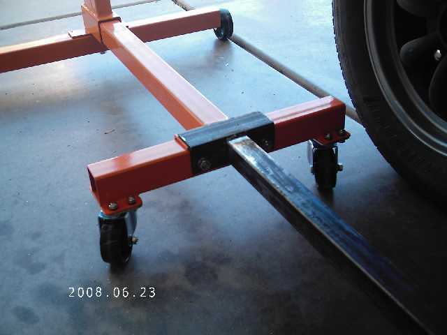

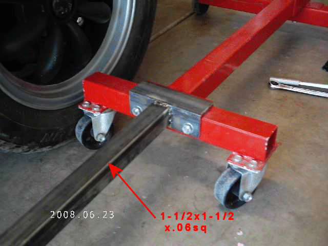

Today I was able to complete the remaining steel support that connects the two engine stands. Once I got the measurements right & cut it, I needed to grind it to fit the two angles used to bolt it to the stands.
It was then welded to the the angle pieces. The angles can then be removed along with the support until the car is up on the stands, then re-attached.
It was too hot to do much else. I spend all day in the sun working, so I can only last a few more hours in the garage with no cooling. Then its a cold refreshing shower and I've got my second wind.
