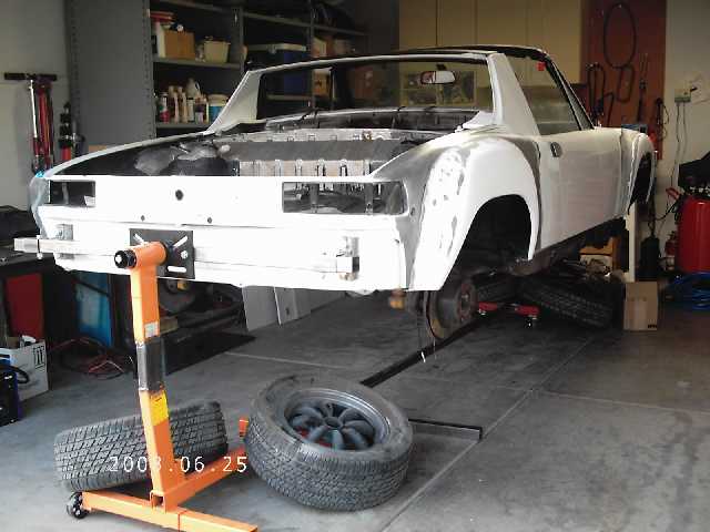

Well I got the car up on the rotisserie tonight. A friend of mine came over and helped. It went pretty well except that I need to build a small (12-18" high) extension for my ATV lift so that I can jack a greater distance. I'm not fond of using wood blocking - so it will give me chance to develop my welding skills a little further.
SOo now I'm ready to get back on the body work and get the flares finished and the rear trunk stripped and primed.
May have some exciting news tomorrow regarding power-train. Stay tuned!
