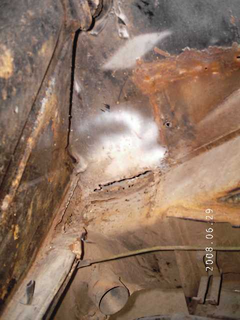

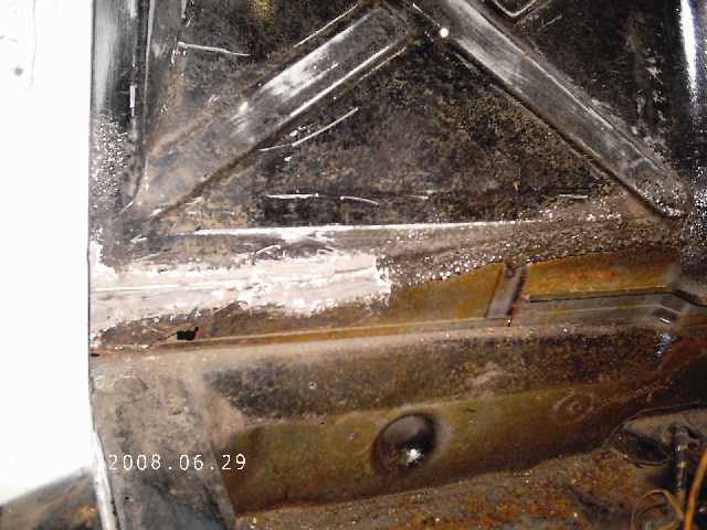

Well I spent MORE time in the trunk stripping paint - and I'm still not finished. In between applications of paint remover I was working on the engine bay. I removed a metal plate that someone installed as a band-aid for the "hell-hole". SO it looks like I'll be hunting for the pieces to fix this. Battery tray was garbage, and I knew there was some work to do there since the rust was obvious in spite of the band-aid.
I'll likely relocate the battery, but I may end up with more room in the engine bay than any where else. And if it stays in the engine bay, it may still get relocated to a lower, more stable location.
I also removed the rubber liner behind the back-pad. If you're interested in saving this liner, the best way to remove it is with a chisel or stout paint scraper. That way you can get behind the pad everytime you encounter cement, and free it before it tears the pad.
Everything else looks clean except for the lower right corner where the "hell-hole" came through the firewall.
