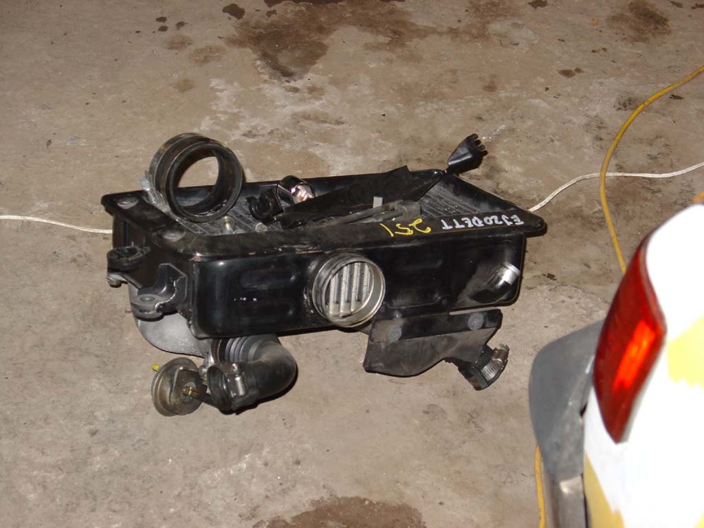

Mo Engine Pics. Lat night I pulled the intake manifold off. Getting this thing going is going to be a bastard. There are an ungodly amount of tubes, sensors, etc.
This is the (air to air) intercooler.
