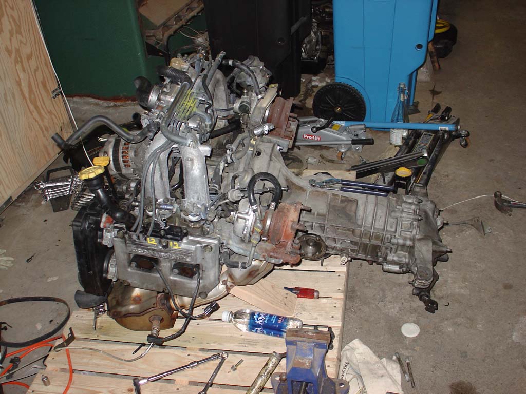

This evening I bolted the dummy transmission to the subaru motor.
Please excuse the mess in my garage.
Here is an aft view.

post Jan 4 2004, 05:25 PM
Turbo Megasquirted Subaru Member
Posts: 2,828
Joined: 7-April 03
From: San Francisco, CA
Member No.: 530
Side shot of engine with intake on backwards (just looking for fit).

fiid   Mo Engine Pics. Lat night I pulled the intake man...   Jan 4 2004, 05:22 PM
fiid   Aft shot of engine with intake on backards.   Jan 4 2004, 05:25 PM
