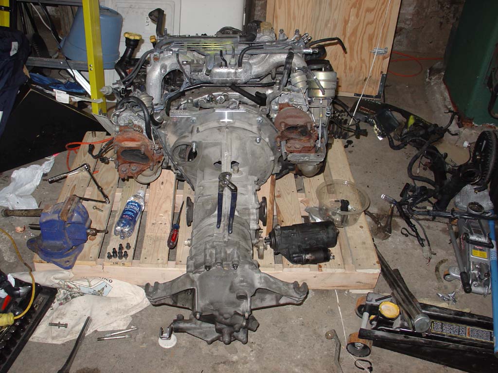

This evening I bolted the dummy transmission to the subaru motor.
Please excuse the mess in my garage.
Here is an aft view.

fiid   Now here's the problem. The starter motor rel...   Jan 3 2004, 01:02 AM

fiid   Anyone have a suggestion on how to get around the ...   Jan 3 2004, 01:05 AM

Brad Roberts   Gear reduction starter (189.00) will clear fine. ...   Jan 3 2004, 01:15 AM
fiid   Where do I get one? Doesn't it look great? ...   Jan 3 2004, 01:18 AM
Brad Roberts   The exhaust is going to be really easy and a COMPL...   Jan 3 2004, 01:20 AM
BIGKAT_83   The IMI HI TORQ starters can be indexed to differe...   Jan 3 2004, 01:21 AM
Brad Roberts   I lied. 159.00 Specify BUS tranny when calling. 8...   Jan 3 2004, 01:24 AM
fiid   Hmmm... apparently there is a chevy part that will...   Jan 3 2004, 01:29 AM
fiid   Sometimes - I should just shut up.   Jan 3 2004, 01:30 AM
fiid   > If any of you are looking for a small body gear ...   Jan 3 2004, 01:31 AM

soloracer   With the starter so close to a potentially red hot...   Jan 3 2004, 10:47 AM
Andyrew   Header wrap the starter?   Jan 3 2004, 10:58 AM
BIGKAT_83
  Jan 3 2004, 07:58 PM
Brad Roberts   But the solenoid was in the same place as stock an...   Jan 3 2004, 08:22 PM
Brad Roberts   Oh.. and I would imagine you would have to modify ...   Jan 3 2004, 08:24 PM
John2kx   I was thinking the same thing Brad......about havi...   Jan 3 2004, 08:39 PM
John2kx   Fiid, This might shine a little more light on the...   Jan 3 2004, 08:41 PM
Brad Roberts   We can actaully move his engine forward several in...   Jan 3 2004, 08:43 PM
John2kx   I didn't think about that B. Since my drivetr...   Jan 4 2004, 06:46 AM
Brad Roberts   I try not to think.. but sometimes it gets in my w...   Jan 4 2004, 11:53 AM
