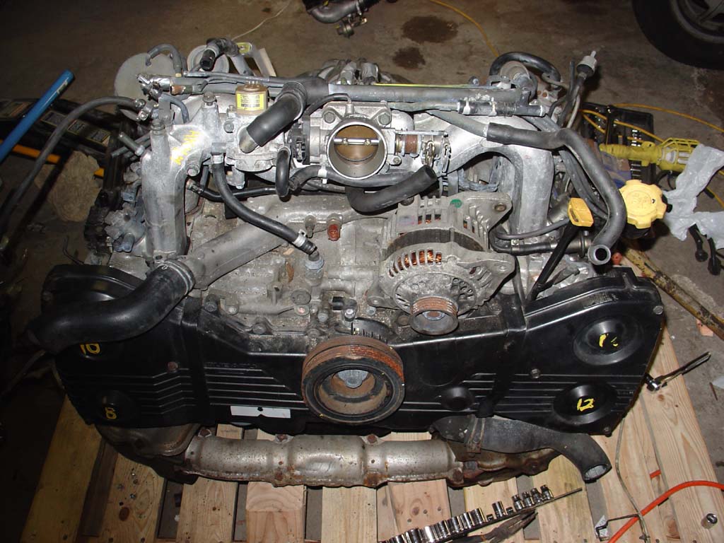

Front view of engine with alternator resting approx where it will be, and intake manifold backwards.

fiid   Mo Engine Pics. Lat night I pulled the intake man...   Jan 4 2004, 05:22 PM
fiid   Side shot of engine with intake on backwards (just...   Jan 4 2004, 05:25 PM
fiid   Aft shot of engine with intake on backards.   Jan 4 2004, 05:25 PM

ChrisReale   Fiid, whats the HP and torque figures of this engi...   Jan 4 2004, 05:43 PM
fiid   ~ 275 HP ~ 275 foot pounds I will get it installe...   Jan 4 2004, 05:47 PM
fiid   Oh yeah - I may be able to get more hp and torque ...   Jan 4 2004, 05:48 PM
