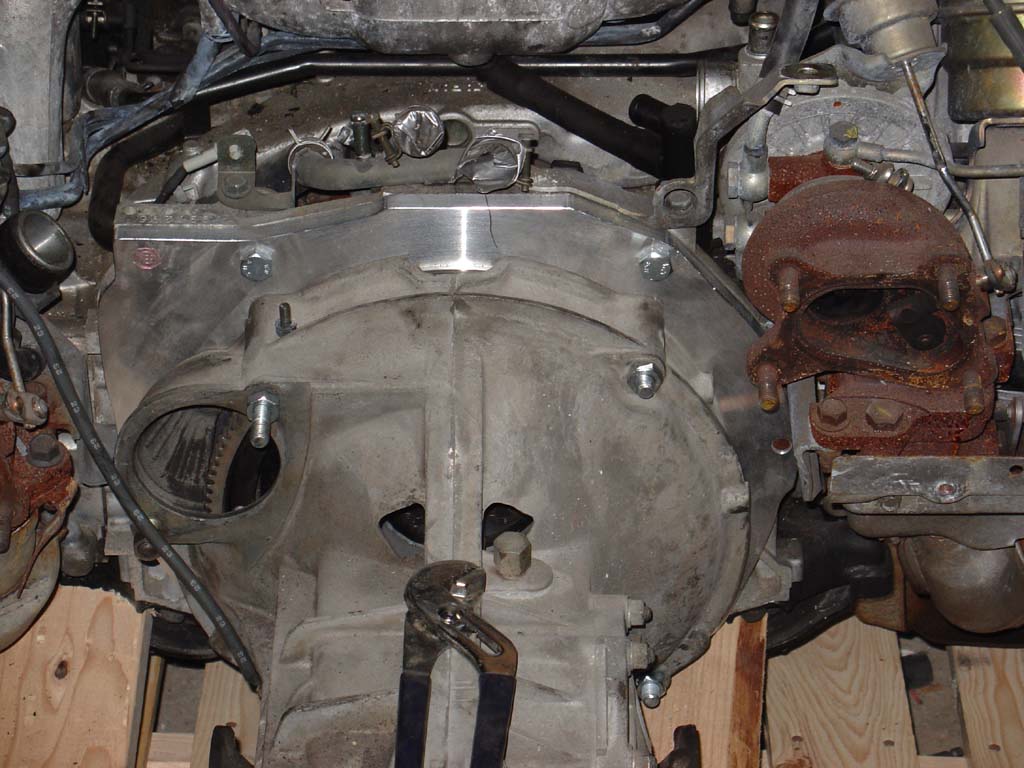

This evening I bolted the dummy transmission to the subaru motor.
Please excuse the mess in my garage.
Here is an aft view.

Close up of Kennedy Adaptor plate. At the top you can see the ports that supply water to the heater element in a subaru. I will probably just put a hose from one to the other. This water circuit also goes through the intake manifold and throttle body - presumably to warm the charge in the cold.

fiid   Now here's the problem. The starter motor rel...   Jan 3 2004, 01:02 AM

fiid   Anyone have a suggestion on how to get around the ...   Jan 3 2004, 01:05 AM

Brad Roberts   Gear reduction starter (189.00) will clear fine. ...   Jan 3 2004, 01:15 AM
fiid   Where do I get one? Doesn't it look great? ...   Jan 3 2004, 01:18 AM
Brad Roberts   The exhaust is going to be really easy and a COMPL...   Jan 3 2004, 01:20 AM
BIGKAT_83   The IMI HI TORQ starters can be indexed to differe...   Jan 3 2004, 01:21 AM
Brad Roberts   I lied. 159.00 Specify BUS tranny when calling. 8...   Jan 3 2004, 01:24 AM
fiid   Hmmm... apparently there is a chevy part that will...   Jan 3 2004, 01:29 AM
fiid   Sometimes - I should just shut up.   Jan 3 2004, 01:30 AM
fiid   > If any of you are looking for a small body gear ...   Jan 3 2004, 01:31 AM
Brad Roberts   I agree :lol: :mueba: B   Jan 3 2004, 01:32 AM
