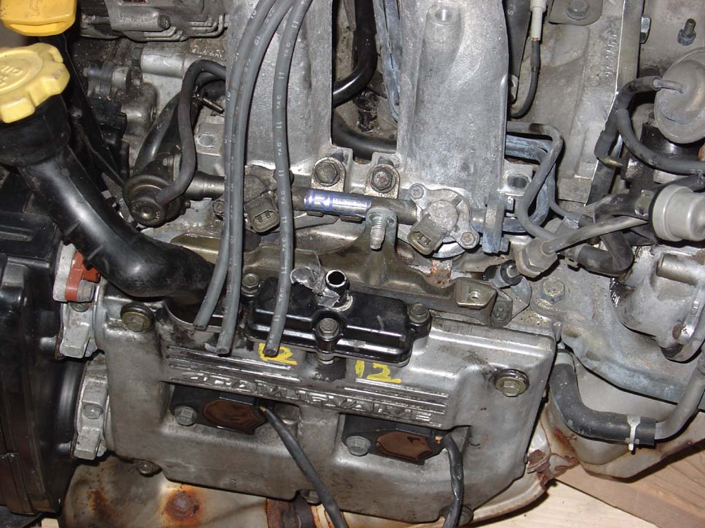

This is the oil filler neck and intake runners (1 & 2 cylinders). To the right, there is some interference between some fuel rail stuffage and the turbo. The bracket behind the filler neck has to be modified to clear the neck, and this holds up the water expansion tank.
