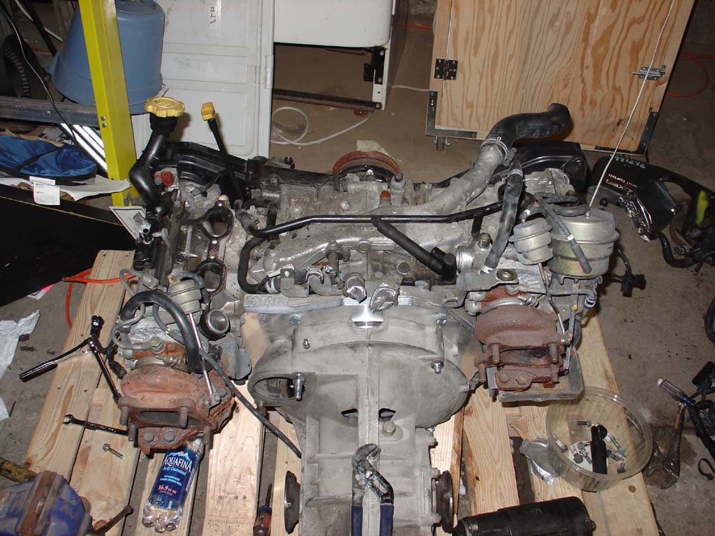

This evening I bolted the dummy transmission to the subaru motor.
Please excuse the mess in my garage.
Here is an aft view.

The engine and tranny with no intake manifold.

fiid   Now here's the problem. The starter motor rel...   Jan 3 2004, 01:02 AM

fiid   Anyone have a suggestion on how to get around the ...   Jan 3 2004, 01:05 AM

Brad Roberts   Gear reduction starter (189.00) will clear fine. ...   Jan 3 2004, 01:15 AM
fiid   Where do I get one? Doesn't it look great? ...   Jan 3 2004, 01:18 AM
Brad Roberts   The exhaust is going to be really easy and a COMPL...   Jan 3 2004, 01:20 AM
BIGKAT_83   The IMI HI TORQ starters can be indexed to differe...   Jan 3 2004, 01:21 AM
Brad Roberts   I lied. 159.00 Specify BUS tranny when calling. 8...   Jan 3 2004, 01:24 AM
fiid   Hmmm... apparently there is a chevy part that will...   Jan 3 2004, 01:29 AM

soloracer   With the starter so close to a potentially red hot...   Jan 3 2004, 10:47 AM
Andyrew   Header wrap the starter?   Jan 3 2004, 10:58 AM

Brad Roberts   But the solenoid was in the same place as stock an...   Jan 3 2004, 08:22 PM
Brad Roberts   Oh.. and I would imagine you would have to modify ...   Jan 3 2004, 08:24 PM
John2kx   I was thinking the same thing Brad......about havi...   Jan 3 2004, 08:39 PM
John2kx   Fiid, This might shine a little more light on the...   Jan 3 2004, 08:41 PM
Brad Roberts   We can actaully move his engine forward several in...   Jan 3 2004, 08:43 PM
