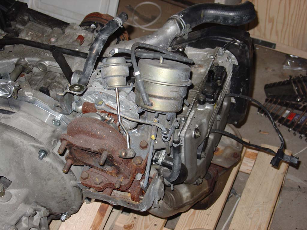

Closeup of right side stage 2 turbo. The large air-bellows here are the sensor or control (not sure which) that allows exhaust to flow in to this turbo. Next to it is the wastegate controller for this turbo.
I am worried about this lot interfering with the body, since this is right next to the transmission/engine border.
