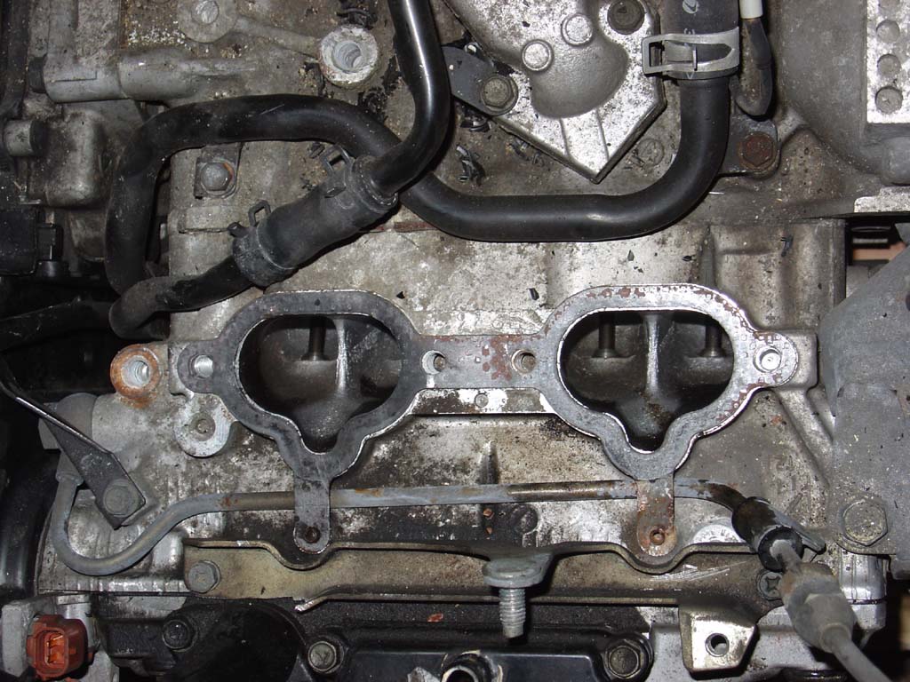

MMMMMMMMM. Intake valves.
The line shown here is the oil supply to the Stage 1 turbo.
You can see my modified bracket at the bottom of the picture.
