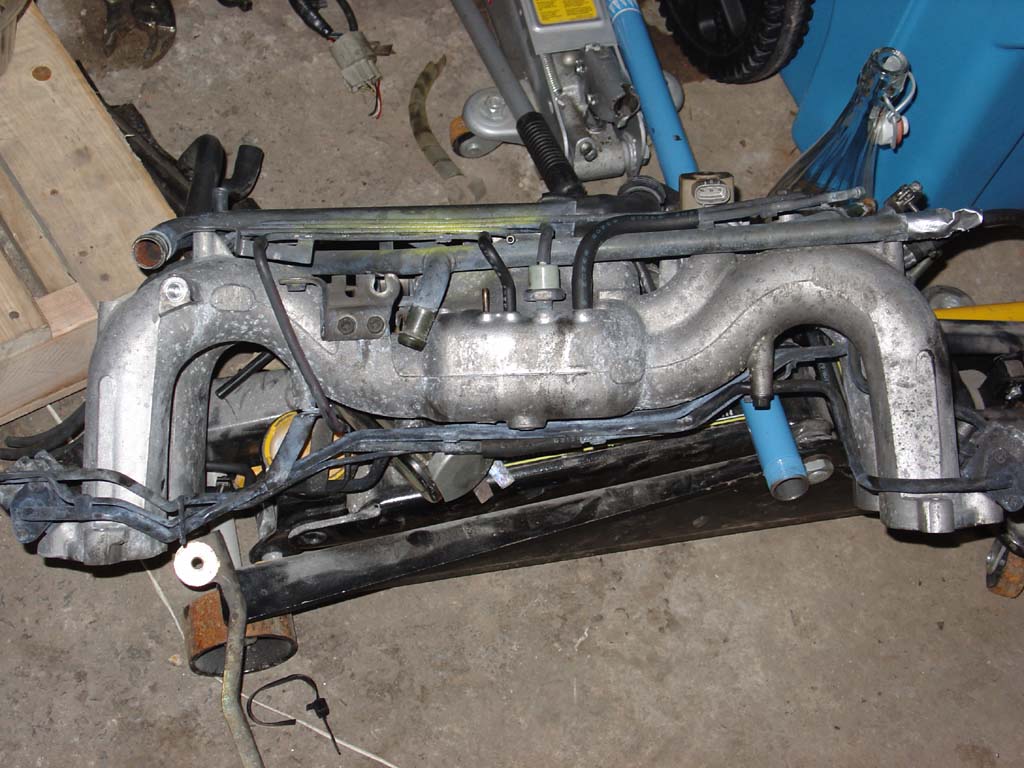

fiid   Mo Engine Pics. Lat night I pulled the intake man...   Jan 4 2004, 05:22 PM
fiid   Side shot of engine with intake on backwards (just...   Jan 4 2004, 05:25 PM
fiid   Aft shot of engine with intake on backards.   Jan 4 2004, 05:25 PM

fiid   This is the oil filler neck and intake runners (1 ...   Jan 4 2004, 05:32 PM
fiid   The engine and tranny with no intake manifold.   Jan 4 2004, 05:33 PM
