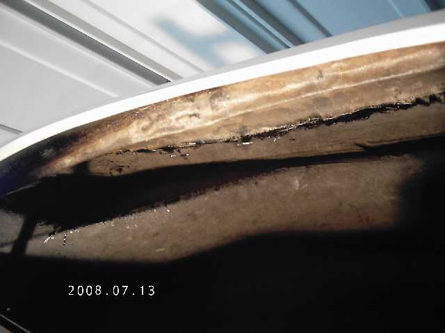

3d914   I worked on the left rear quarter today. I needed ...   Jul 13 2008, 04:07 PM
