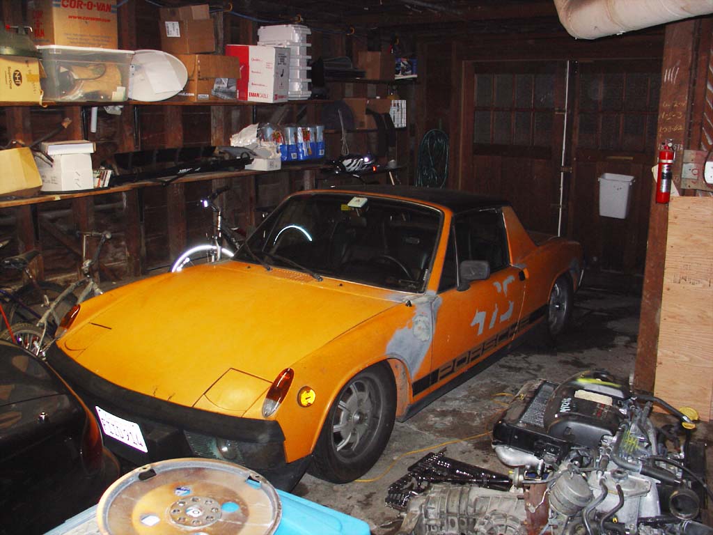

This evening I bolted the dummy transmission to the subaru motor.
Please excuse the mess in my garage.
Here is an aft view.

fiid   Mo Engine Pics. Lat night I pulled the intake man...   Jan 4 2004, 05:22 PM
fiid   Side shot of engine with intake on backwards (just...   Jan 4 2004, 05:25 PM
fiid   Aft shot of engine with intake on backards.   Jan 4 2004, 05:25 PM
fiid   Front view of engine with alternator resting appro...   Jan 4 2004, 05:26 PM
fiid   Close up of Kennedy Adaptor plate. At the top you...   Jan 4 2004, 05:28 PM
fiid   This is the oil filler neck and intake runners (1 ...   Jan 4 2004, 05:32 PM
fiid   The engine and tranny with no intake manifold.   Jan 4 2004, 05:33 PM
fiid   Closeup of right side stage 2 turbo. The large ai...   Jan 4 2004, 05:35 PM
fiid   MMMMMMMMM. Intake valves. The line shown here is...   Jan 4 2004, 05:37 PM
fiid   And here is a 4 legged alien.   Jan 4 2004, 05:38 PM
fiid   Another fun thing about this engine. There are br...   Jan 4 2004, 05:39 PM
ChrisReale   Fiid, whats the HP and torque figures of this engi...   Jan 4 2004, 05:43 PM
fiid   ~ 275 HP ~ 275 foot pounds I will get it installe...   Jan 4 2004, 05:47 PM
fiid   Oh yeah - I may be able to get more hp and torque ...   Jan 4 2004, 05:48 PM
