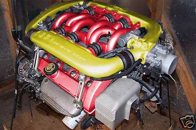

This week I've been working on the engine. It works out better to spend time on the engine for a few hours in the late afternoon and save the body work for the weekend.
The engine is coming along. Tom's been a big help getting things squared away. We've got a good block, crank, rods, pistons, heads, intake, etc. I've started cleaning and some assembly. I'll begin prepping for paint next week.
There are two complimentary colors on the car in addition to the Orange. When racing the GT's the factory would color code the bumpers so that each car could be identified easier when viewed head-on. I plan to apply this to my car and use yellow and red for the two halve-colors on the front & rear bumpers. These are the same colors I'll use for the engine.
Here's a quick image my son modified for me to illustrate. The block and oil pan will also be yellow to match the intake. I wanted to avoid black since the engine cover is a black mesh. This way the colors will be more apparent behind the black grill.
Can't wait to get the engine painted and together.
