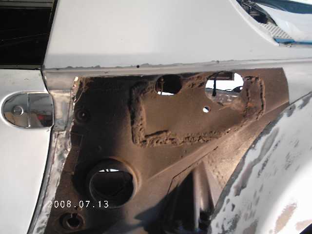

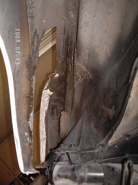

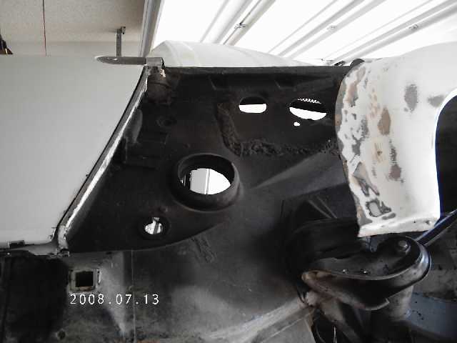

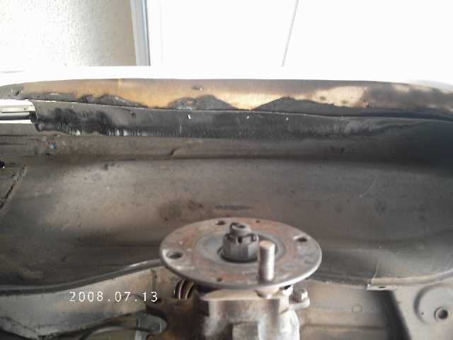

I worked on the left rear quarter today. I needed to get the access metal behind the flares trimmed out. To do this I went ahead and trimmed the adjacent area where the new body panel goes in.
I used my 4in cutter to rough-cut the area.
then followed with my Dremel tool to get a nice clean cut.
I was able to pry off the sheet metal under the flare without damaging the flare at all. Since the sheet metal was a thin strip a couple inches wide, it flexed quite easily and there was no real pressure on the FG flare. Here's a shot from behind the flare. Now I just have to grind off the adhesive on the back side of the flare before applying new adhesive.
All that was left was to trim the access sheet metal behind the flare. I use my Dremel tool for this since it provides good control and I don't have to worry about damaging the flare. I use the big cutter to remove the strip of sheet metal once it reaches 18in or so. Here's the trimmed underside ready to be prepped for fiberglass.
It's getting there - slowly but surely.
