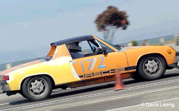

The numbers thing didn't bother me that much since I needed a paint job anyway (although it was kinda stupid.).

fiid   Here is my car at Laguna Seca with the dreaded num...   Jan 5 2004, 01:17 PM
