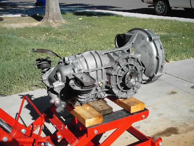

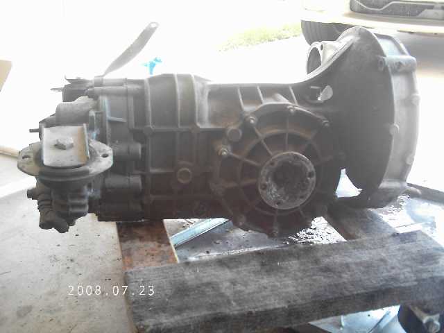

Well I've managed to get the transaxle completely cleaned. I used POR-15's Marine Clean. At a 1:1 dilution with water it does an amazing job. I use both nylon & soft-metal brushes to loosen the grease and grime, then just rinse with water. Too easy.
Here's a before and after.
I ran out of POR Paint Stripper and Marine Clean, so I think I'll work on painting the valve covers and modifying the intake manifolds this weekend. The tranny inspection can wait till next week.
