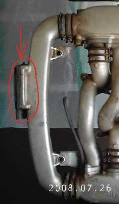

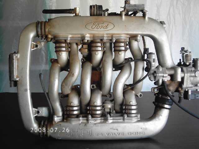

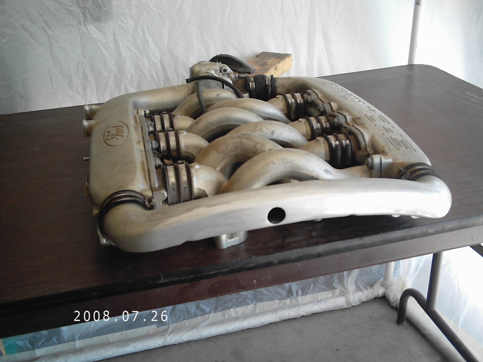

Speaking of which - I worked on the valve covers & intake manifold today. The valve covers just needed minor cleaning and light sanding. They have a coating on them (I don't think it anodizing), so I need to find out if this can be painted on or not.
Started to disassemble the intake manifold. Here's the beast with most attachments.
I need to remove several bosses that I will not be using and will help reduce the length for a better fit. The first to go is the DIS flange.
To remove it I first cut off large sections top & bottom, then started to grind and file down close to the desired shape. I continued to rough the shape with a file, then did some sanding with 60 & 100 grit. The hole will get welded in and then I will finish it all off. But there are several other smaller flanges that need to come off also.
I like aluminum . . .
