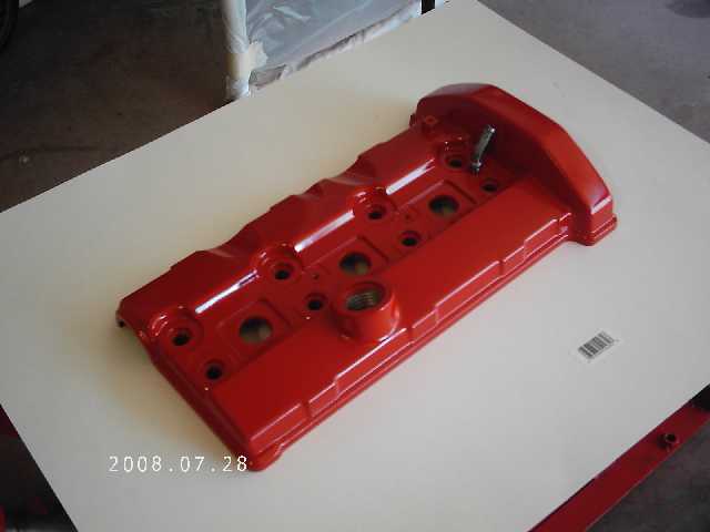

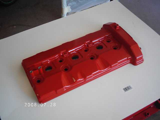

post Jul 28 2008, 07:03 PM
Posts: 1,275
Joined: 24-September 03
From: Benson, AZ
Member No.: 1,191
Now that the Valve covers are dry, here's how they look in Ford Red (Duplicolor 500deg paint)
and
purty . . . (but not the best JPEGs)
