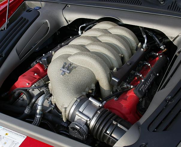

That intake looks bitchin in raw Al. Reminds me of something you would see on a vintage aircraft. And, I would do the valve cover in red wrinkle coat. Like the Maserati Spyder...

3d914   Now that the Valve covers are dry, here's how ...   Jul 28 2008, 07:03 PM
jasons   You know, I hate to meddle with your paint choices...   Jul 28 2008, 07:24 PM
3d914   Jason, I agree - that wrinkle affect looks cool. ...   Aug 1 2008, 05:07 PM
