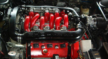

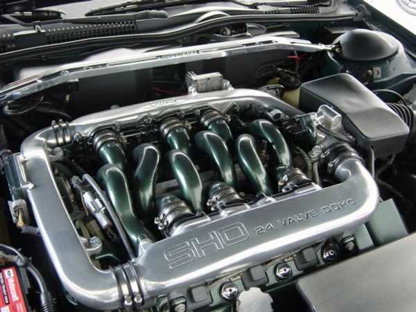

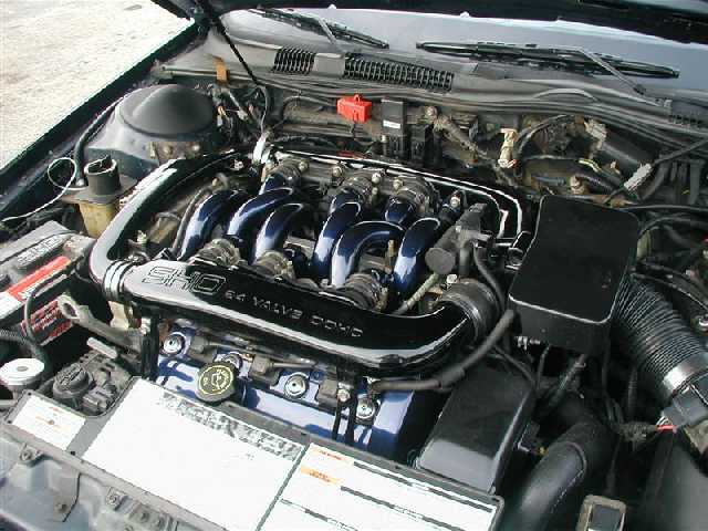

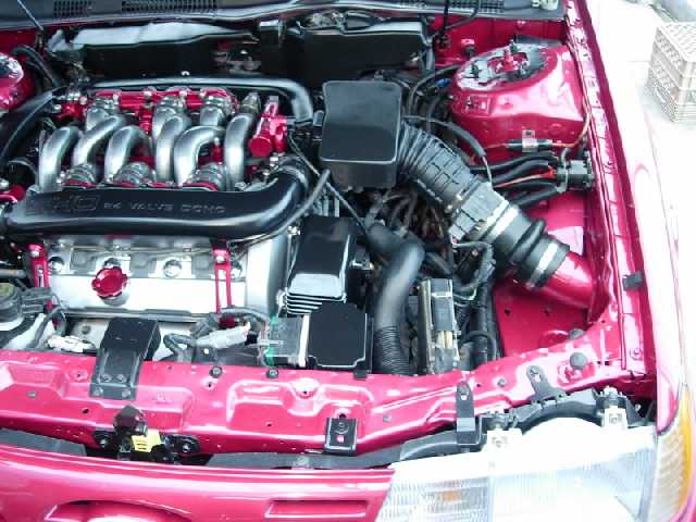

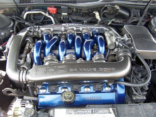

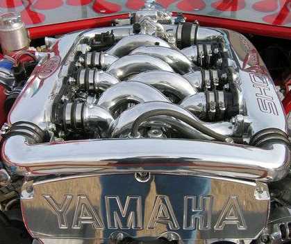

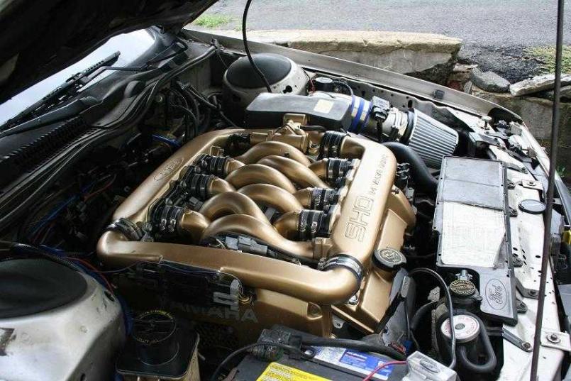

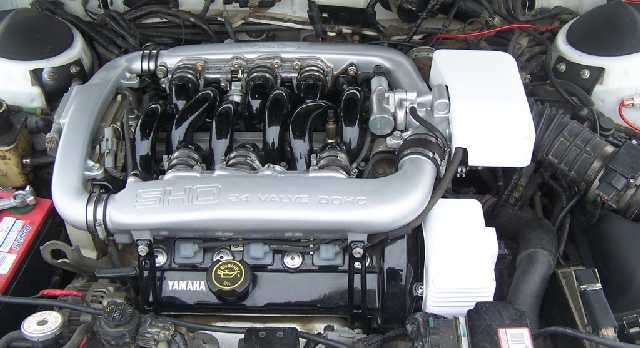

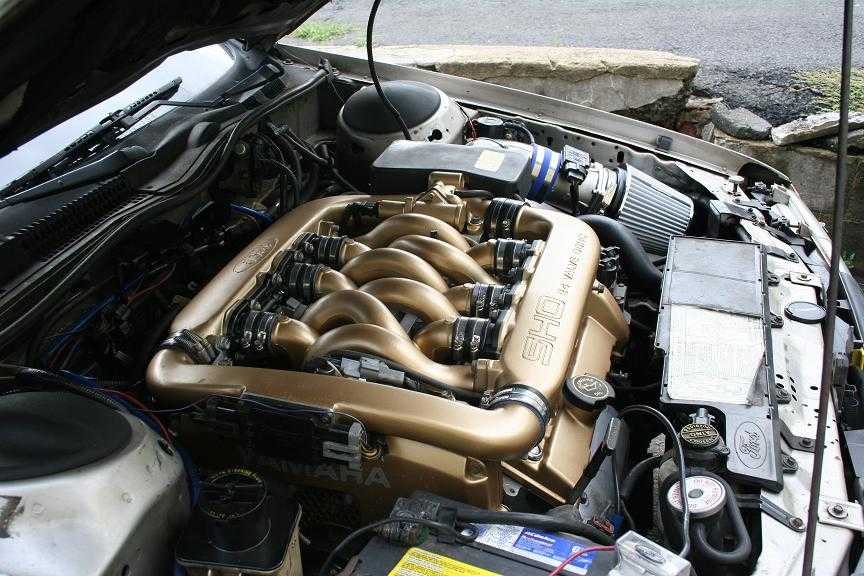

Definitely. Here are some examples . . .
SHO Bling . . .
Purty (IMG:style_emoticons/default/aktion035.gif)

Eric_Shea   When I was in the SHO club there were some guys wh...   Aug 2 2008, 10:56 PM
3d914   Definitely. Here are some examples . . . SHO Blin...   Aug 4 2008, 10:15 PM
