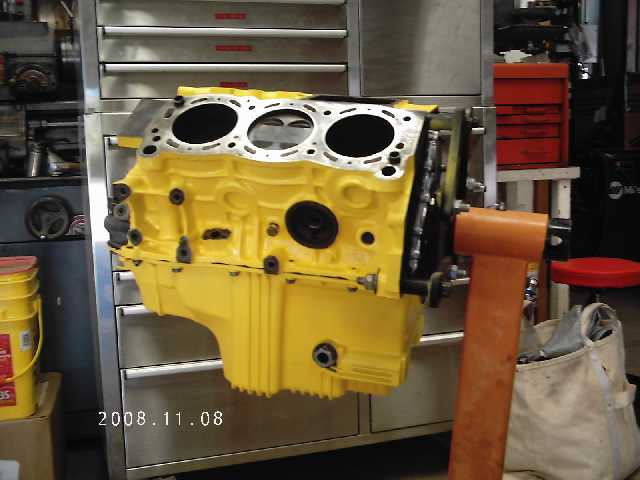

OK, finally the engine is going together. He's where my list is at compared to a couple months back.
Engine rebuild . . .
  • Cleaned and painted the oil pan
  • Cleaned and painted the block
  • Cleaned the heads and valve covers
  • Cleaned and painted the valve covers
  • Modified and welded the intake manifold
  • Cleaned and painted the intake manifold
  • Cleaned and painted the intake runners
  • Had the heads professionally cleaned and decked
  • Replaced numerous freeze block plugs
Now that reassembly has begun, it should be done in three or four weekends. Of course I still have numerous parts to gather or recondition (water pump, some sensors, exhaust, etc).
To say I'm glad to have reached this point is an understatement. I'm glad I'm not on a schedule.
Here's a picture of the current status. Once I find the head bolts I can continue . . .
