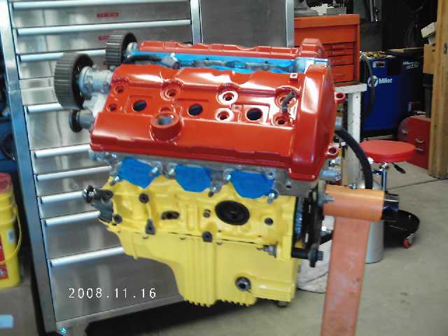

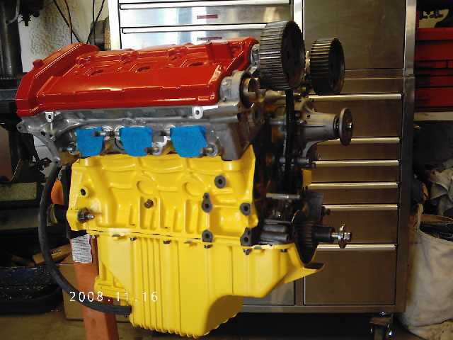

OK, got some more done on the engine this weekend - thanks Tom!
Heads are on & valve covers are just sitting there waiting to put the seal/gasket on.
The crank position sensor is mounted and gapped.
A remanufactured waterpump Tom had available is also installed, along with the main tubing and housings for the head cooling.
Here are the pics so far:
Purtty,

So.Cal.914   Did you swap in 3.0 cams?   Nov 16 2008, 09:51 PM
rick 918-S   Wow, that's a tall oil pan. You may need to sh...   Nov 17 2008, 08:39 AM
3d914   No 3.0 cams. I think the stock 3.2 is going to be ...   Nov 17 2008, 12:07 PM
