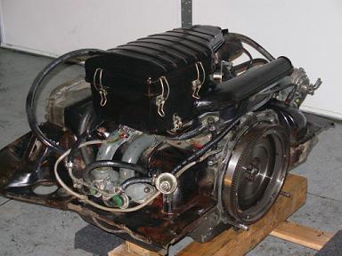

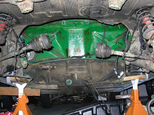

It's been a few months since my last update. The project got side tracked for a bit while I tackled some medium sized rust issues in the inner rocker on both sides. I cut out the rusted areas, killed rust and coated entire inner long. Welded in new sections. And then I decided to install the long kit from Brad Mayeur. This ties the trailing arm to the longs and adds a great amount of stiffening. I'm really happy with the results.
This weekend I pulled the 2.0L and transaxle after doing a compression test. Compression looks great (136,125,132,126). Spent the day cleaning and getting ready to sell. I was surprised at how much bigger the typeIV is then the suby motor, with all the air cooled components. Even with the added radiator, the suby setup will be smaller and lighter.
Received my KEP adapter and flywheel package, high quality stuff. Also talked the guys at Small Car Performance into selling me a set of motor mount arms. They no longer have the painted style, they have moved to a new powder coated set which is quite a bit more expensive. But after I begged for a while they sold me just the arms from the powder coated set for about the same as the old style.
Also received my cams back from Delta, got a new water pump, timing belt and cam shaft oil seals.
Next will be to clean up the engine bay, minor hell hole repair, and paint the engine bay.
