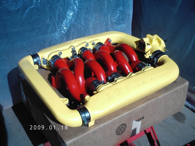

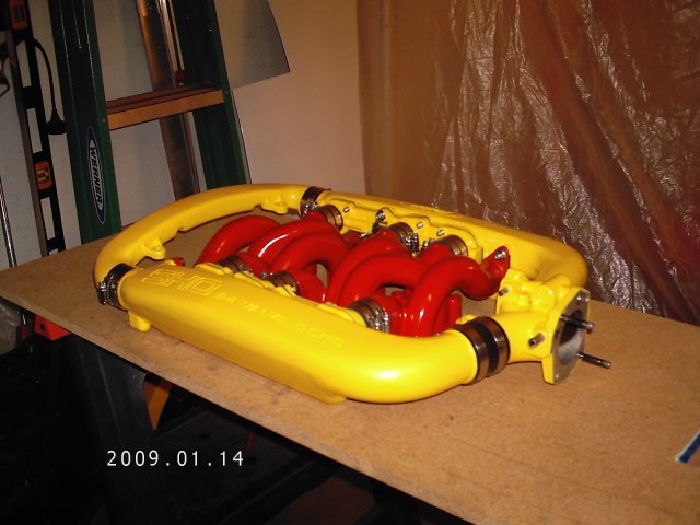

A lot of time has gone by, but progress continues slowly. Here is the pre-assembly of the famous SHO Intake Manifold. I've been taking my time making sure everything is fitting together properly.
(Here are two pics. For some reason the yellow gets washed out in the sun)

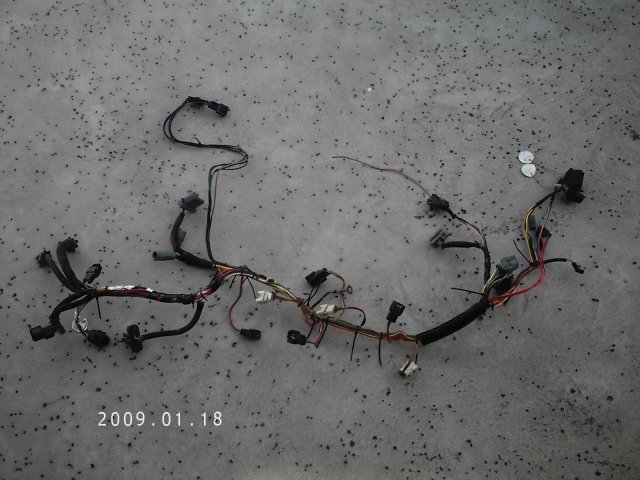

Since the wiring harness sits under the intake between the fuel injector rails, I have a lot of work to do on the harness. I got it cleaned up & removed all the old dried out tape and insulator. Some lines will need to be extended for my application so all that will get done before the test run.
