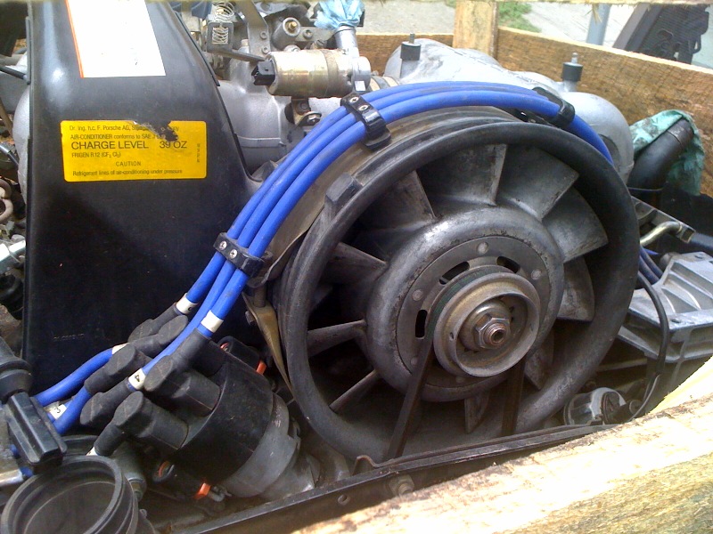

I sold the 3.0 and got an '85 3.2 DME. It arrived today. (IMG:style_emoticons/default/aktion035.gif)

Nana's_914   Anyone try flipping the intake 180° on the 3.2 to...   Jul 30 2009, 06:13 PM
John   Anyone try flipping the intake 180° on the 3.2 t...   Aug 19 2010, 08:15 PM
Nana's_914   Anyone try flipping the intake 180° on the 3.2 ...   Aug 19 2010, 10:45 PM
Steve   [quote name='Nana's_914' post='1358572' date='...   Aug 20 2010, 08:45 AM

MoveQik   Here's how mine looks. No cutting or eliminat...   Aug 20 2010, 08:42 AM
