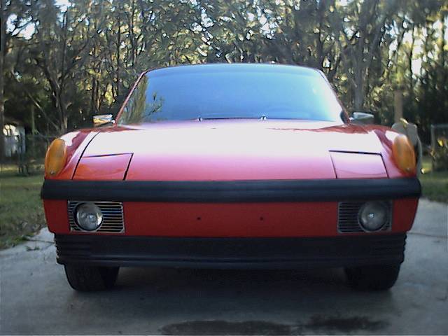

just to have a record on this board, i am in the process of installing driving lights where the fog lights go. i got some well-prepared grills from korjo. the lights mentioned in the attachment, made by Pilot, are indeed available from Auto Zone. About $45. I had the brackets made at a local shop. I'll let you know how it turns out.

I think yellow fogs would finish the look.

jfort   got the Pilot driving lights installed, finally. ...   Mar 15 2004, 02:18 PM
