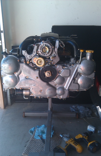

First pics of my EZ30R engine with 1000 miles total!
Now to take out the Ej20 turbo this weekend and see if the new engine can fit on the renegade engine cradle!

one more on stand

Travis Neff   Nice!   Apr 1 2010, 10:09 PM
DBCooper   VERY nice! I can't wait to see how this t...   Apr 1 2010, 10:14 PM
GS Guy   I've long thought that would be the ultimate ...   Apr 2 2010, 05:31 AM
Zaney   I missed if this Six is going to be N/A or turboed...   Apr 2 2010, 11:51 AM
