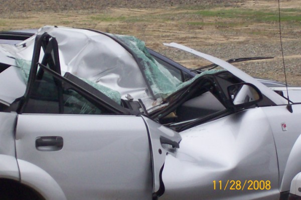

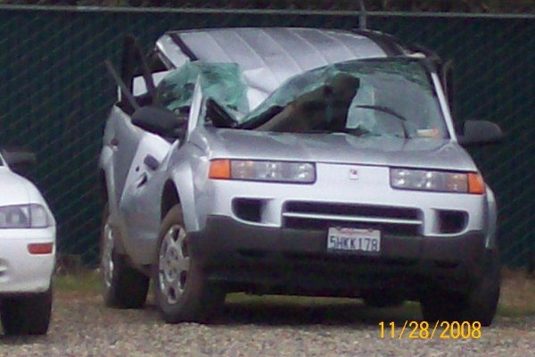

PS.. This replaced our Vue, which blew a new Bridgestone on a corner on a wet day, before Thanksgiving. Just thankful they all came out next day, battered but alive. The cottonwood was the only thing that kept them from landing in the creek upside down. My oldest was sitting seat belted in on the passenger side, but ended up in the back seat. Had he stayed in his seat, there is no doubt that it would have not turned out well for him. Happy Easter and best of luck getting your vehcles back on the road. Especially that fugly Forrester. Now there is a car that has a profile only its owner could love (IMG:style_emoticons/default/biggrin.gif) (IMG:style_emoticons/default/biggrin.gif) (IMG:style_emoticons/default/biggrin.gif) (IMG:style_emoticons/default/biggrin.gif) (IMG:style_emoticons/default/biggrin.gif) (IMG:style_emoticons/default/biggrin.gif) (IMG:style_emoticons/default/biggrin.gif) (IMG:style_emoticons/default/biggrin.gif) (IMG:style_emoticons/default/biggrin.gif)
