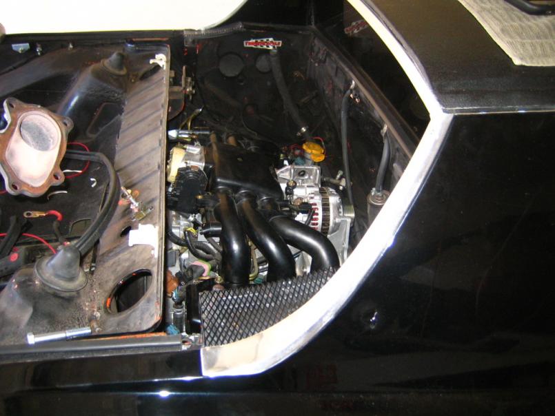

budman5201   Okay almost done guys. Here is my 2003 Boxster Muf...   May 11 2010, 10:18 PM
budman5201   Engine bay is done and engine in....a few pics bef...   May 11 2010, 10:30 PM
budman5201   more   May 11 2010, 10:31 PM
budman5201   more   May 11 2010, 10:32 PM

budman5201   more   May 11 2010, 10:33 PM
budman5201   more   May 11 2010, 10:34 PM

budman5201   fuzzy pic, but drivers side of exhaust done, now p...   May 18 2010, 11:23 PM
