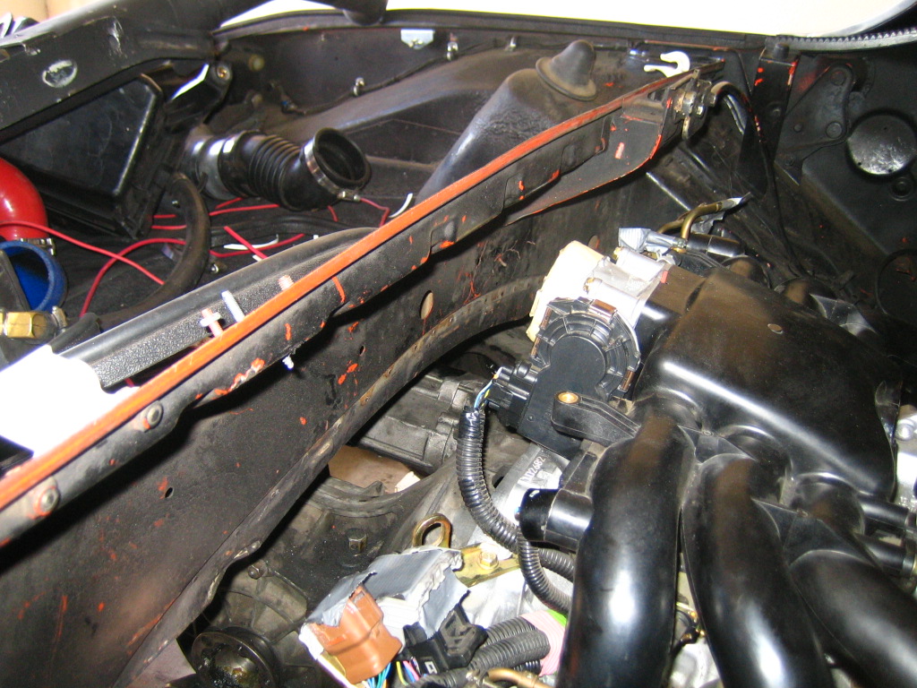

look at all that space around throttle body!

budman5201   WOW! doesnt that EZ30R look like it was made f...   Apr 5 2010, 06:09 PM
budman5201   another   Apr 5 2010, 06:10 PM
budman5201   look at all that space around throttle body!   Apr 5 2010, 06:10 PM
budman5201   as i stated earlier, engine will be about 1.5 inch...   Apr 5 2010, 06:11 PM

Dr Evil   Friggen awesome :) Just as I had imagined it. You ...   Apr 6 2010, 01:07 AM
Tom   That looks like it will be a screamer alright and ...   Apr 6 2010, 01:36 AM
budman5201   That looks like it will be a screamer alright and...   Apr 6 2010, 02:32 AM
jasons   No I don't think so. In fact I'm going t...   Apr 6 2010, 07:22 AM
Porcharu   Yes cut the unneeded sheet metal out - that stuff ...   Apr 6 2010, 02:14 PM

budman5201   final position of intake, yep slight mod needed to...   Apr 6 2010, 05:02 PM
Andyrew   Reminds me of the 928 intake. Cool!   Apr 6 2010, 05:30 PM

camaroz1985   Can you flip the intake and move the alternator so...   Apr 7 2010, 09:00 AM
budman5201   Can you flip the intake and move the alternator s...   Apr 7 2010, 09:18 AM
camaroz1985   Can you flip the intake and move the alternator ...   Apr 8 2010, 07:09 AM
