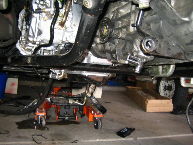

budman5201   side   Apr 2 2010, 09:46 PM
budman5201   Underneath....hey also if anyone knows...Why doesn...   Apr 2 2010, 09:47 PM
kg6dxn   My Dodge V10 has no return line either. It uses a ...   Apr 2 2010, 11:14 PM
