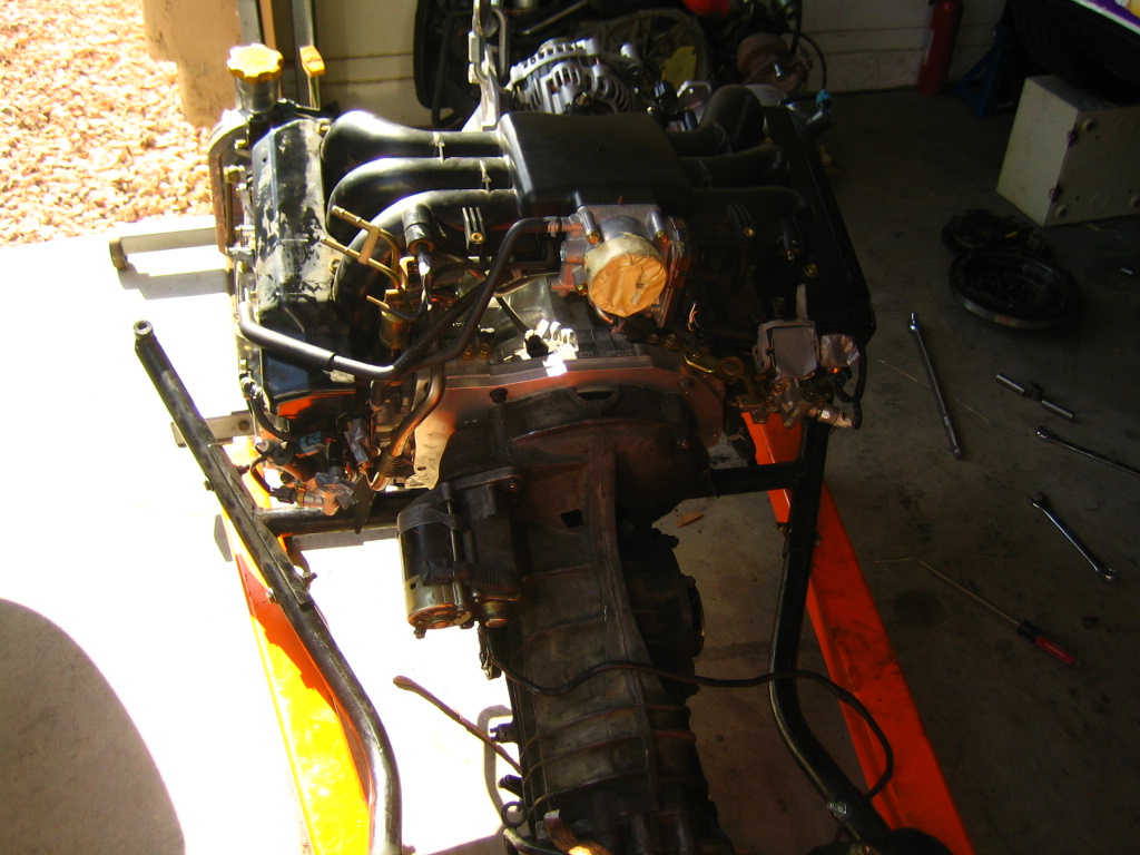

First pics of my EZ30R engine with 1000 miles total!
Now to take out the Ej20 turbo this weekend and see if the new engine can fit on the renegade engine cradle!

on cradle

GS Guy   I've long thought that would be the ultimate ...   Apr 2 2010, 05:31 AM
Zaney   I missed if this Six is going to be N/A or turboed...   Apr 2 2010, 11:51 AM
Porcharu   How about a side view pic so we can see the oil pa...   Apr 2 2010, 01:03 PM

budman5201   EJ20 is out finally! Yes it is the 3 Port Exh...   Apr 2 2010, 09:45 PM
budman5201   side   Apr 2 2010, 09:46 PM
budman5201   Underneath....hey also if anyone knows...Why doesn...   Apr 2 2010, 09:47 PM

FourBlades   That is a beautiful engine. What kind of HP and t...   Apr 3 2010, 01:15 PM

pktzygt   It's a Tribeca. But it's also fugly on the...   Apr 4 2010, 11:38 AM
