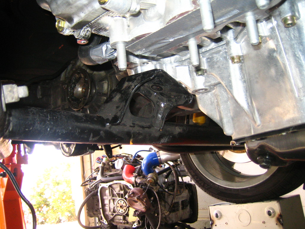

Here is a pic of where the motor mount lines up, waiting on mount to come in mail

budman5201   Here is a pic of where the motor mount lines up, w...   Apr 5 2010, 06:38 PM
budman5201   side clearance   Apr 5 2010, 06:43 PM
budman5201   passenger side clearance   Apr 5 2010, 06:44 PM

budman5201   Fits like a glove. Stock Subaru mounts fit right i...   Apr 6 2010, 04:59 PM
budman5201   The oil Pan is Perfect. Great clearance !   Apr 6 2010, 05:00 PM
budman5201   side view   Apr 6 2010, 05:00 PM
