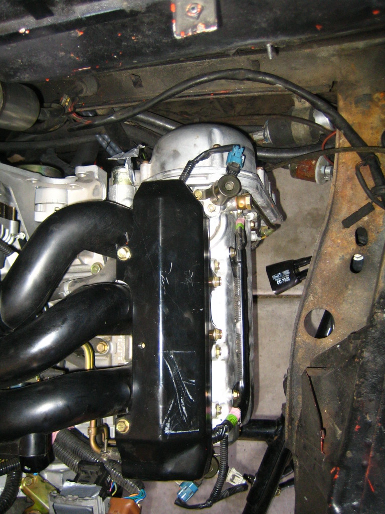

budman5201   Quick mockup of header, will redo in quality steel...   Apr 7 2010, 10:00 PM
budman5201   rear without collector yet (using this FMC one)   Apr 7 2010, 10:01 PM

budman5201   header driver side complete   Apr 12 2010, 08:27 PM
