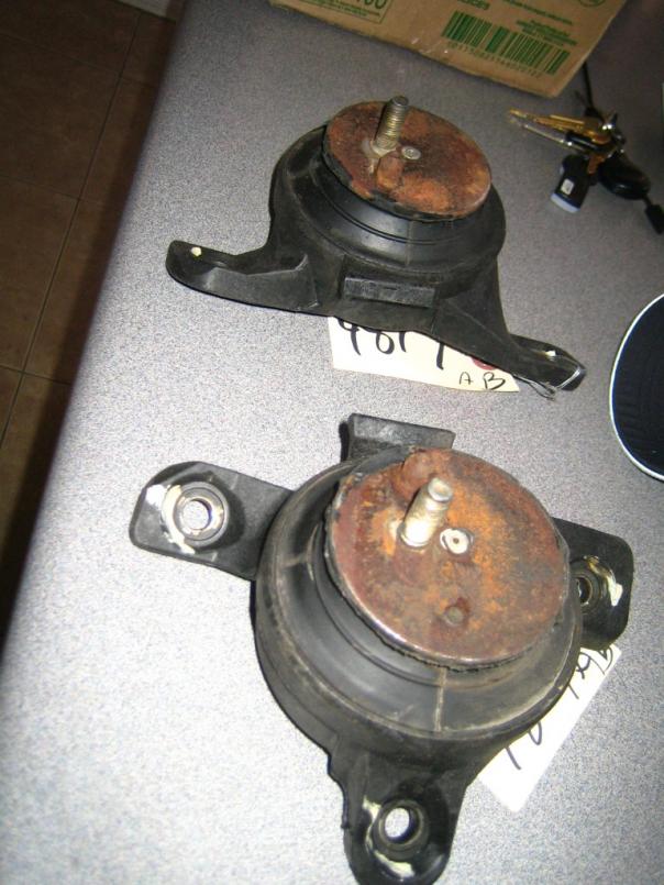

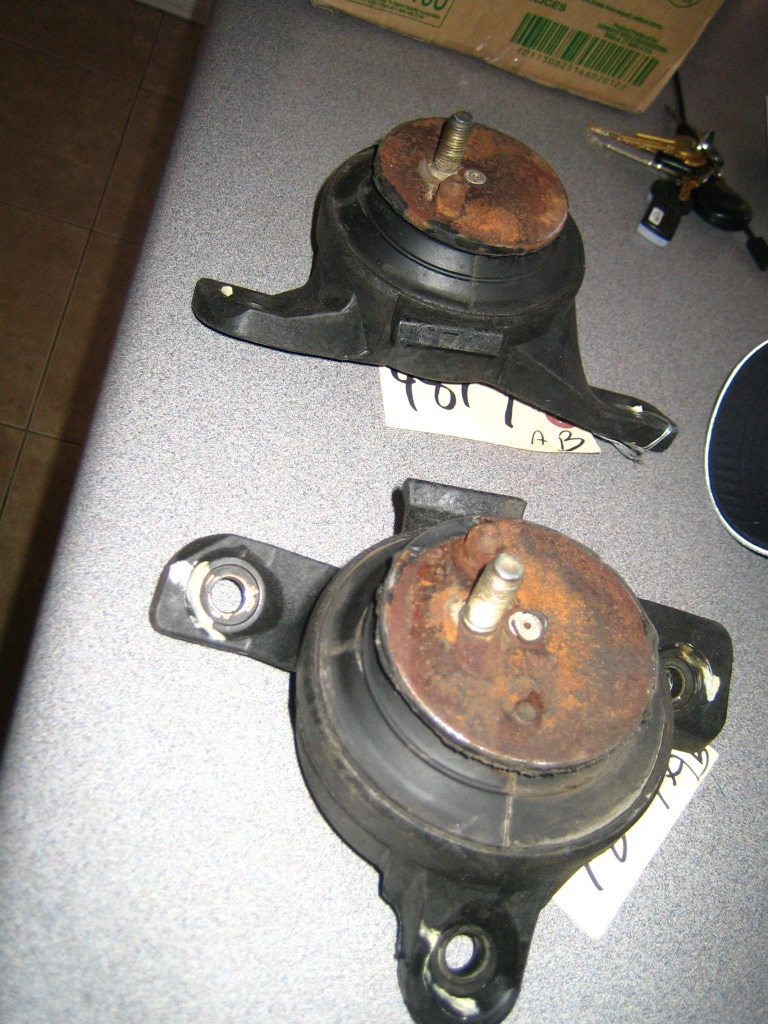

Member No.: 7,635
Fits like a glove. Stock Subaru mounts fit right into the holes of the renegade mount. Only mod was to made the holes slightly wider on the mount where the mount bolt comes through. The 3.0 liter mount had the 2 studs on the mount a little closer together. But same angle, and slipped right into the 2.0 mount location! Sweet!
