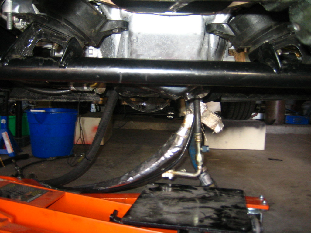

budman5201   Fits like a glove. Stock Subaru mounts fit right i...   Apr 6 2010, 04:59 PM
budman5201   The oil Pan is Perfect. Great clearance !   Apr 6 2010, 05:00 PM
budman5201   side view   Apr 6 2010, 05:00 PM
budman5201   final position of intake, yep slight mod needed to...   Apr 6 2010, 05:02 PM
