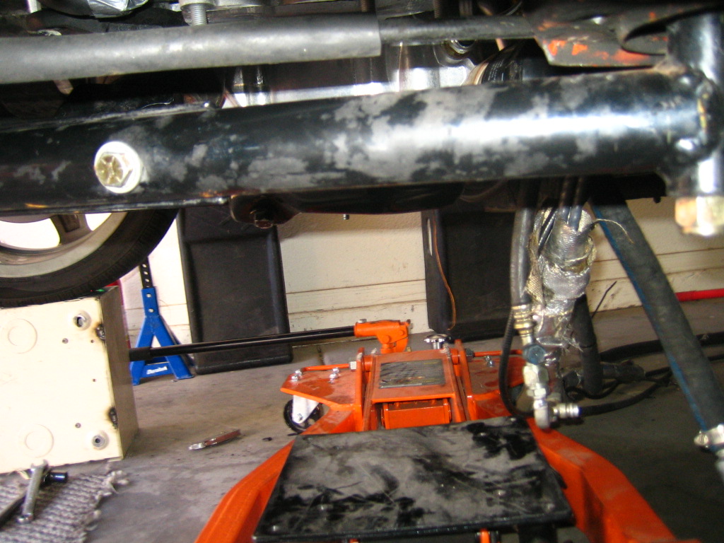

budman5201   WOW! doesnt that EZ30R look like it was made f...   Apr 5 2010, 06:09 PM
budman5201   another   Apr 5 2010, 06:10 PM
budman5201   look at all that space around throttle body!   Apr 5 2010, 06:10 PM
budman5201   as i stated earlier, engine will be about 1.5 inch...   Apr 5 2010, 06:11 PM
budman5201   on cradle   Apr 5 2010, 06:12 PM
budman5201   Here is a pic of where the motor mount lines up, w...   Apr 5 2010, 06:38 PM
budman5201   side clearance   Apr 5 2010, 06:43 PM
budman5201   passenger side clearance   Apr 5 2010, 06:44 PM

budman5201   Fits like a glove. Stock Subaru mounts fit right i...   Apr 6 2010, 04:59 PM
budman5201   The oil Pan is Perfect. Great clearance !   Apr 6 2010, 05:00 PM
budman5201   side view   Apr 6 2010, 05:00 PM
budman5201   final position of intake, yep slight mod needed to...   Apr 6 2010, 05:02 PM
