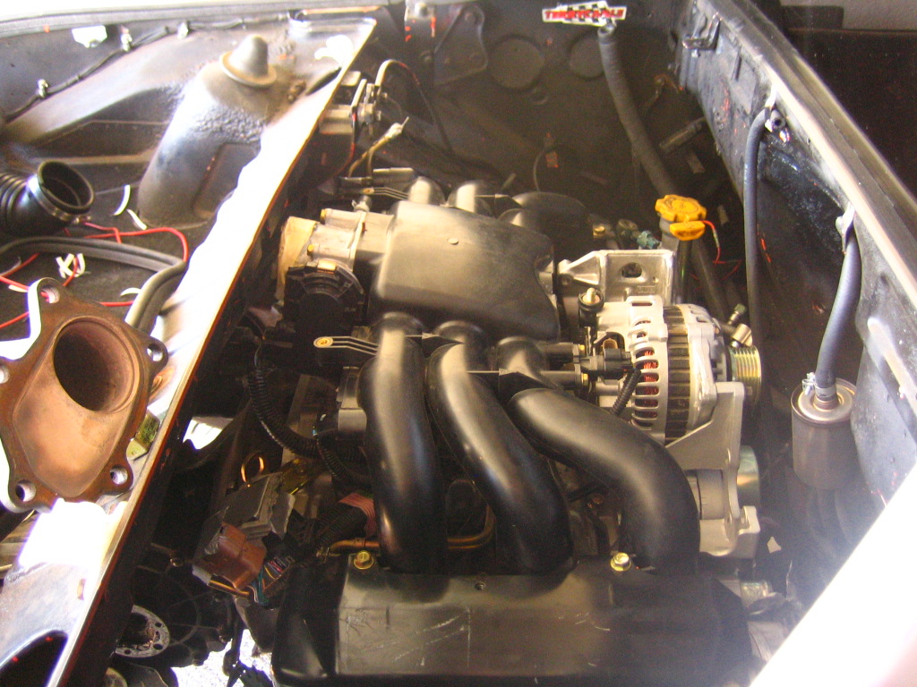

final position of intake, yep slight mod needed to rear firewall, but maybe i might be able to slip a 90 degree Coupler in there.
I like that you can see the Spider intake real well.

budman5201   final position of intake, yep slight mod needed to...   Apr 6 2010, 05:02 PM

camaroz1985   Can you flip the intake and move the alternator so...   Apr 7 2010, 09:00 AM
budman5201   Can you flip the intake and move the alternator s...   Apr 7 2010, 09:18 AM
