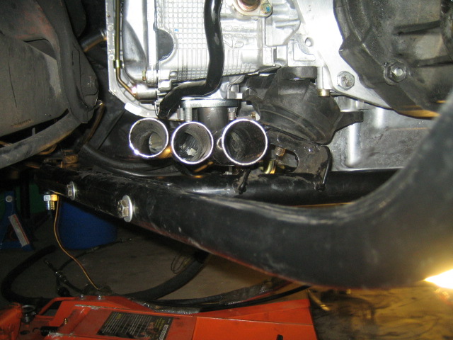

budman5201   header driver side complete   Apr 12 2010, 08:27 PM
