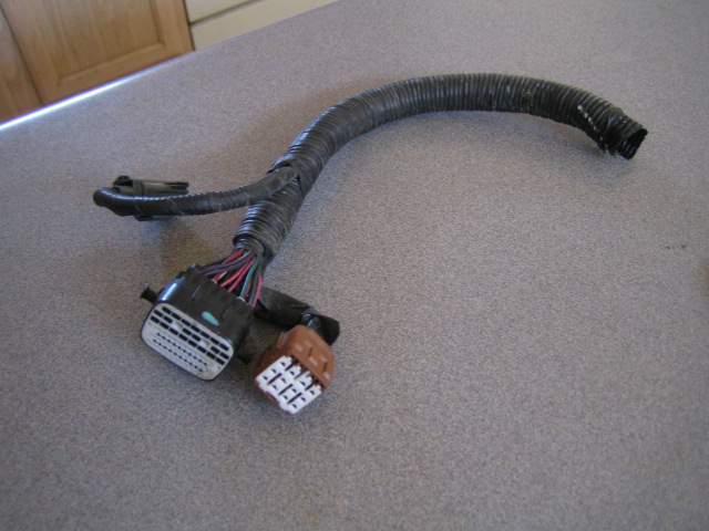

budman5201
post Apr 12 2010, 08:28 PM
Posts: 595
Joined: 1-April 07
From: tempe, az
Member No.: 7,635
received other end to my engine harness! and it fits!! This is going to make wiring a TON easier.
