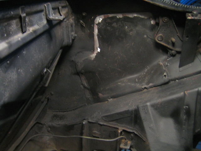

while cleaning up the engine bay, found this patch panel. FUN!!
what a PITA to clean up.

budman5201   while cleaning up the engine bay, found this patch...   Apr 16 2010, 09:31 PM
budman5201   pic of behind patch panel, to be fixed this week v...   Apr 18 2010, 11:48 PM
budman5201   So far 8 hours spent on just engine bay, no where ...   Apr 19 2010, 10:02 PM
