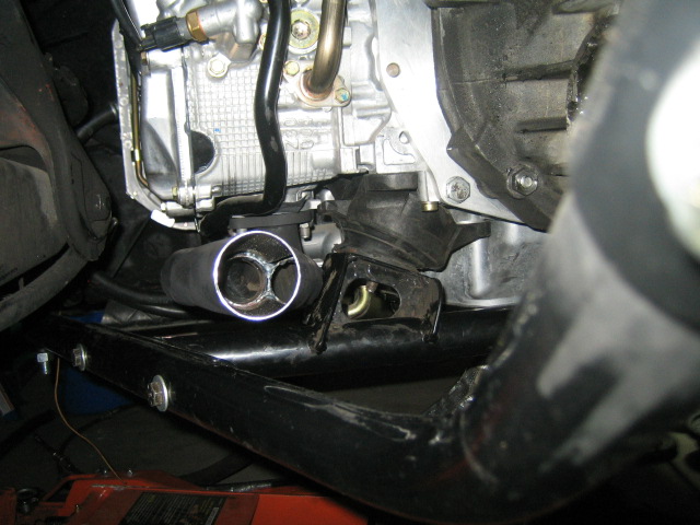

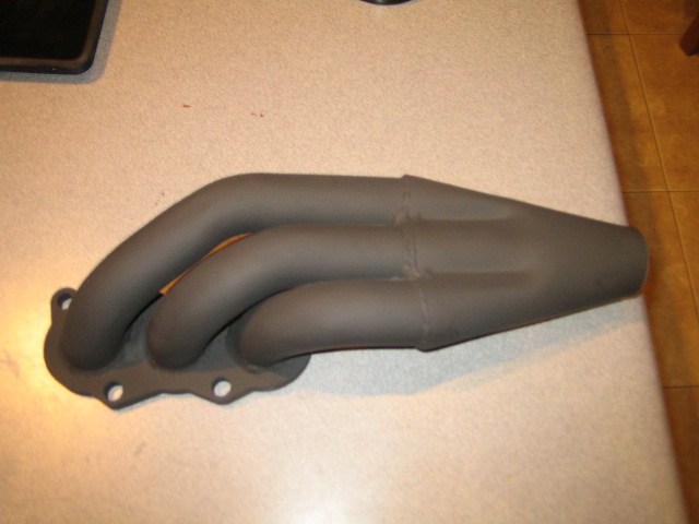

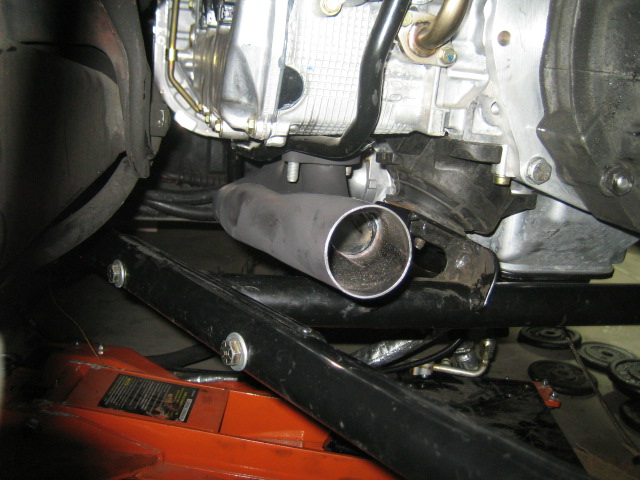

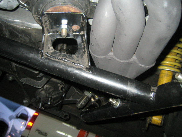

header driver side complete

QUOTE(budman5201 @ Apr 12 2010, 07:27 PM) *
This is a great thread that I'm gonna watch closely. However, I'd be a little worried about the clearance between the exhaust manifold and engine mount bar -- it seems a bit close. I would bet that those two items might hit on accel/decel and make some untoward noises...
