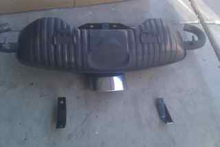

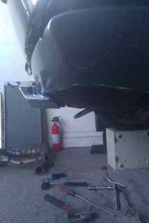

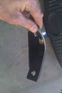

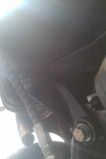

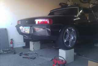

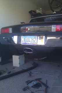

Okay almost done guys. Here is my 2003 Boxster Muffler, I cant believe how nice it came out.
Check out the brackets needed to fab. They bolt directly to Transmission Main Stock mounting bolts for the weight and small ones on rear of transmission for stabilization not weight.
(sorrry for the crappy cell phone pics)
