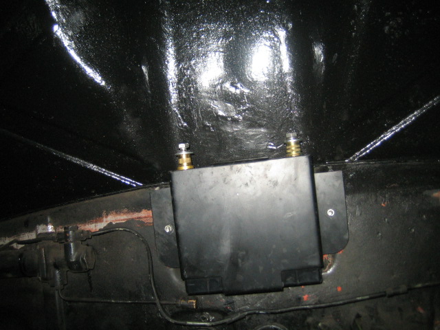

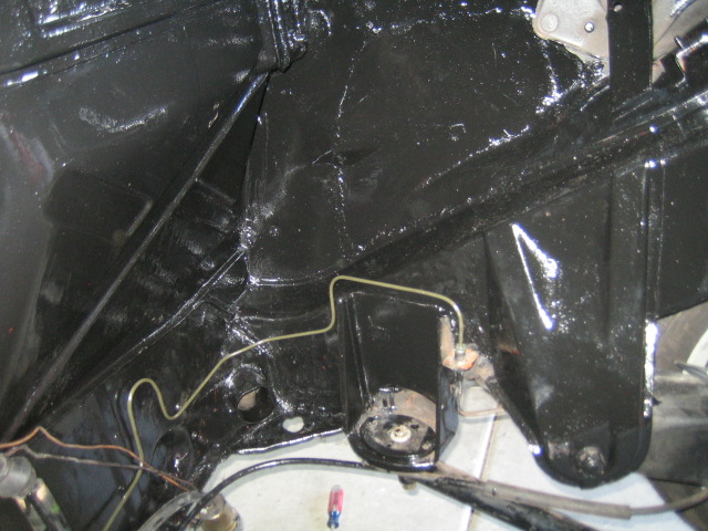

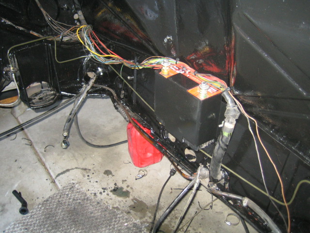

Engine bay is done and engine in....a few pics before and after. Look at my nice small battery tucked down low in front of engine. Cranks over engine just fine!
Yep my welding is NOT clean, but very solid. It litterally took me about 24 total hours just to plug all the holes from previous owners and take away all the air cooled sheet metal. Battery box area done and hell hole area was solid when i was sanding it.
Clutch CABLE tube also moved to other side of tunnel. Solid FOREVER now.

boxstr   Curious, why the battery so far down low and, to m...   May 11 2010, 11:14 PM
budman5201   Curious, why the battery so far down low and, to ...   May 11 2010, 11:47 PM

charliew   I like the muffler and the battery location. You a...   May 12 2010, 10:37 AM
budman5201   I like the muffler and the battery location. You ...   May 12 2010, 02:09 PM
