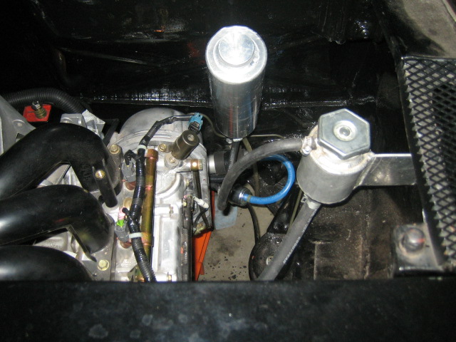

fuzzy pic, but drivers side of exhaust done, now passenger side is left.
Coolant overflow and purge tank are now in and connected, Radiator hose back to engine is connected.

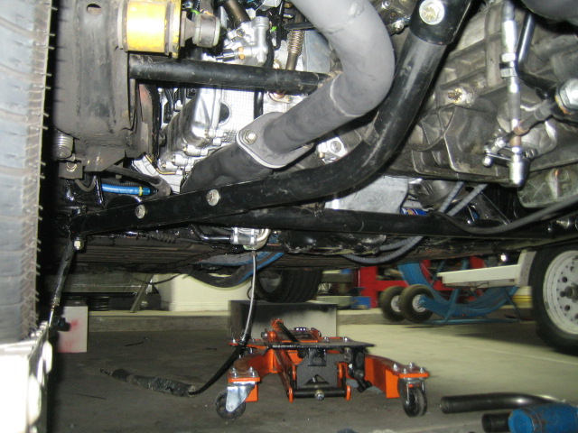

budman5201   EJ20 is out finally! Yes it is the 3 Port Exh...   Apr 2 2010, 09:45 PM
budman5201   side   Apr 2 2010, 09:46 PM
budman5201   Underneath....hey also if anyone knows...Why doesn...   Apr 2 2010, 09:47 PM

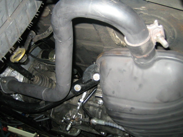

budman5201   Okay almost done guys. Here is my 2003 Boxster Muf...   May 11 2010, 10:18 PM

budman5201   fuzzy pic, but drivers side of exhaust done, now p...   May 18 2010, 11:23 PM
