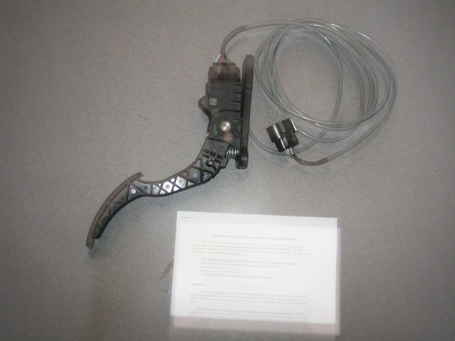

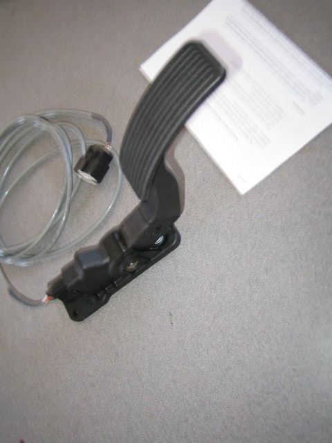

My electronic throttle finally arrived!! Should be wired into this weekend and i'll try to take a video of the throttle plate opening on car with pedal. (IMG:style_emoticons/default/beer3.gif)
wow too much coffee while taking pics today, very fuzzy!

budman5201   Working on electronic throttle today. It's ama...   May 14 2010, 09:40 AM
budman5201   fuzzy pic, but drivers side of exhaust done, now p...   May 18 2010, 11:23 PM
budman5201   My electronic throttle finally arrived!! S...   May 20 2010, 05:47 PM
